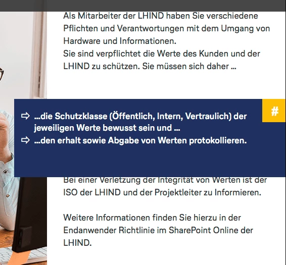

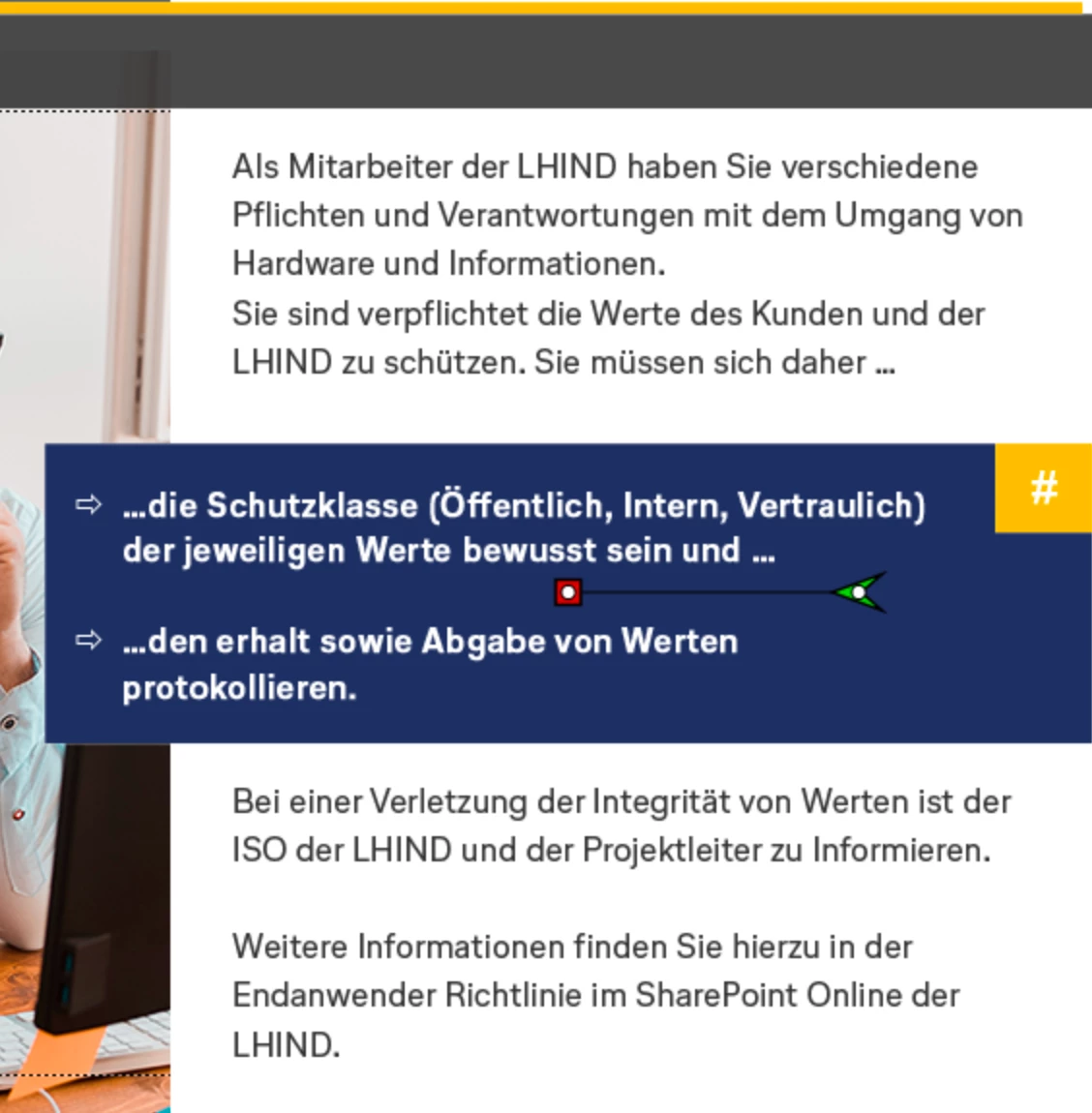

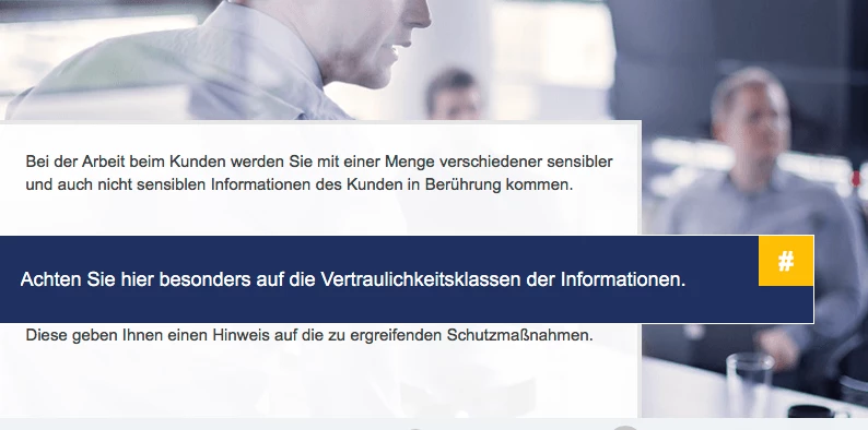

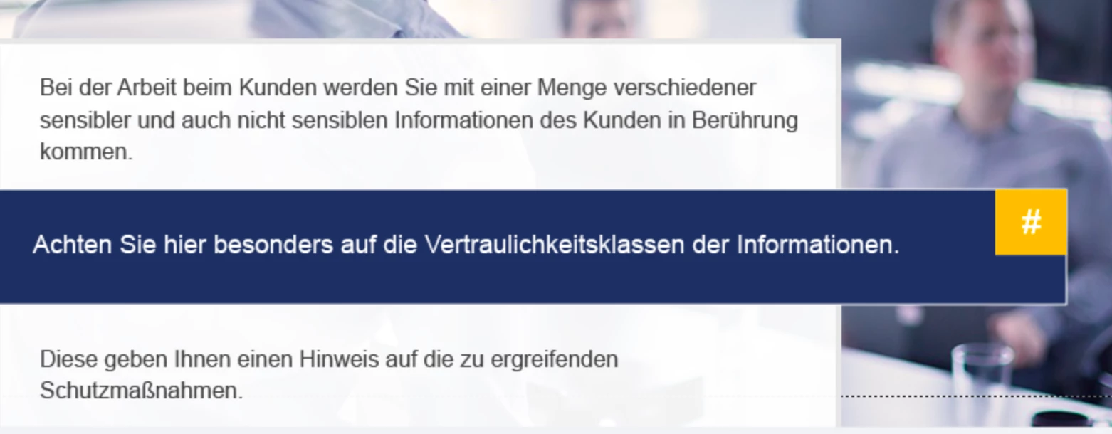

How do I manage that the fonts in the film are shown in the same size as in the construction document?
Second problem: The position oft the fonts are different in the film than in the build file.
