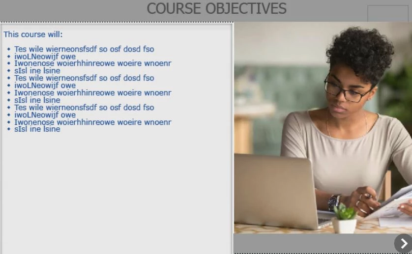

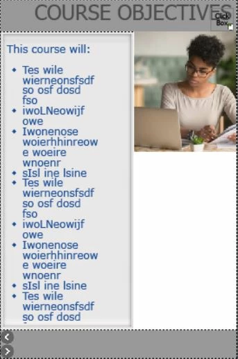

    Jul 15, 2020 6:51 PM UTC
    I tried both. Please see below. - In addition how do I get the mobile to be able to scroll down? If I extend the text fully then it cuts off the navigation. Thanks!
    Lilybiri
    Jul 15, 2020 7:02 PM UTC
    You need to extend the height of the slide beyond the normal size. Creating a good course which looks fine on all devices is not that easy. I would also recommend to decrease the minimum font size if you work with Fluid Boxes. It is set to 14pt which is much too big, you can easily go down to 10 or 8pt.
