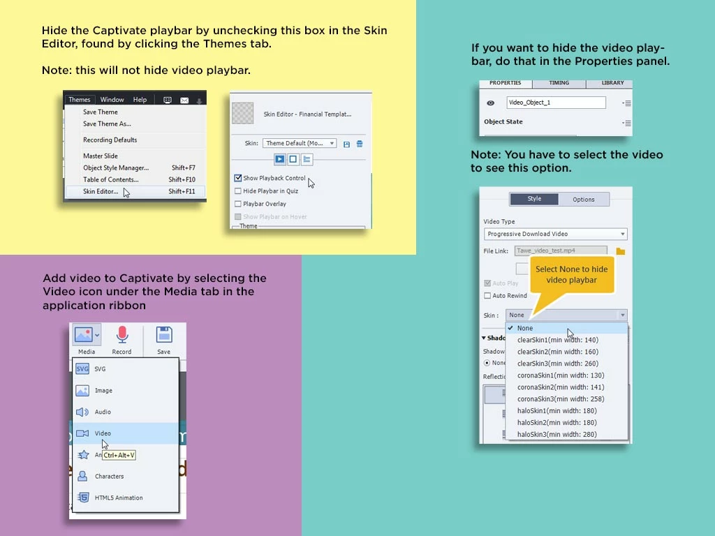

    Hopefully this visual explanation will help you now. (see attached image)
    There are two methods of hiding a playbar in Captivate. One hides the playbar for the course and that is found in the Skin Editor under Themes, the other can hide a playbar on an imported video. If you've exported video from a Captivate file, simply import that video and hide the playbar with the Video Properties. I hope this helps, but if this does not make sense, hopefully someone else will step in with a better understanding of what you are asking.
