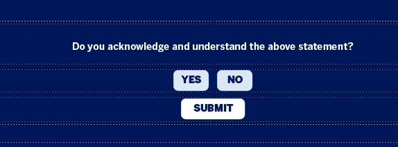

I have created a training course with a yes or no acknowledgment slide at the end (set up like a quiz). Basically the user will progress through all the slides and then click either 'yes' or 'no', then 'submit', at the end to say they comply with the regulations within. If they click 'yes' I need the LMS to report as 'complete' and if they click 'no' I need it to report as 'in progress'. Please can someone tell me what preferences within quiz reporting or other back end areas to tick so this works correctly. It is difficult for me to test as I do not have access to the LMS data so currently a bit of a stab in the dark. Thank you

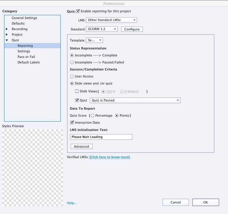

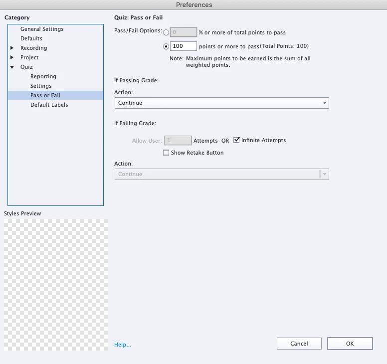

thanks for your reply and advice re Scorm cloud, I have activtated it and all good. However my course is still not behaving the way I want it to. It is not marking as complete even when the Yes button (allocated points) is clicked. Where am I going wrong? Can you help me? Here are my settings.
