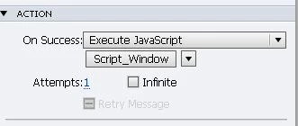

Captivate allows you to run javascript.  It's one of the possible actions you can take on events, right above "Execute advanced actions" there's "Execute Javascript"

Nov 13, 2012 9:38 PM UTC
Im actually building something similar to that right now.
At the first slide set up an array at the root level, this will be a boolean array the length of your quiz and fill it with zeros.  This contains the data where we figure out if a slide has been answered correctly or not.  If a slide is answered correctly it sets its corrosponding array slot to 1.  If not it remains zero.
The first action all slides take is to check if they are answered correctly.  If they have already been answered correctly they are skipped.  The final slide checks to see if all questions have been answered correclty.  If yes, it continues.  If no it starts over.
Pretty simple.

In Captivate no array is possible, so you are talking about Flash or JavaScript?

Nov 13, 2012 9:43 PM UTC
