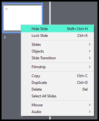

If you just want the slide hidden, you can just right click the slide in the filmstrip panel and select hide slide.
Otherwise, if it were me - I would simply navigate around it.

If the slides will remain hidden throughout - will it work for you to simply hide them in your design mode
with the right click >> hide slide?
Unless there is some need to dynamically hide/unhide a slide during the finished product - that would seem the easiest way.
