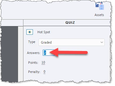

    I think you may be misunderstanding how a hotspot quiz question works.
    When you select the number of "answers" in the quiz properties for this type of question you get that same number of hotspots appear on the slide.  These are actually for specifying the locations of CORRECT answers, not the total number of possible places the learner might happen to click on that slide.
    So, if you only wanted to have TWO correct answers, then you should have selected 2 as the number of "answers"
    Then you move and resize those two hotspots so that they are positioned over the top of where the learner needs to click in order to get the question correct.  If they click anywhere else on the slide the question will be marked wrong, even if they have also clicked in the correct locations as well.
    One last tip, make sure you adjust the Properties of the hotspots so that they are invisible to the user.  By default they will be a very light blue that can still be seen.  You need to change the opacity to 0 otherwise you may be giving away the location of where to click.

    Thanks for explaing this and I understand my issue as I indicated 5 answers, not 2. This is because I wanted three other "incorrect" hotspot areas that "could be" selected. I like the fact that the user knows where a hotspot is because the curson changes to a hand, and I am only "allowing clicks" on existing hotspots. However, it appears that my verson (11.5.1.499) does not allow me to create "custom" hotspots, where some can be wrong, yet still selectable.
    If I limit the answers to only 2, and allow clicks anywhere, the problem is that the 2 active hotspots change the cursor to a "hand", thereby giving away the answer. If the cursor did not change to a hand icon, then I could work around this issue.
