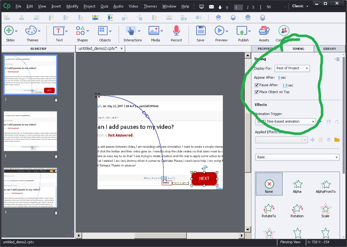

    Lilybiri,
    I am using Captivate 10 and I do not see Any thoughts? Am I missing something? I just want the course to pause until the button is clicked-- do I have to write an advanced action? Your idea seems way faster but I must be missing something. Thanks in advance.  BTW here is what I see:

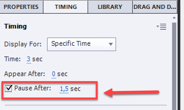

    Lilybiri
    August 14, 2017
    Since Captivate 8 the UI has changed. The former Properties panel is now split up in a Properties and a Timing Properties panel. Pausing is in the Timing Properties panel:
    The indicator you are showing is still there for shape buttons on the master slide, because items on the master slide have no timing properties panel.

    May 25, 2017
    camila,
    This is a very basic way of doing what you want. It is not the best, and you may not find it suitable, but it is a start.
    You can add a button on each slide to Pause until it is clicked to Go To Next Slide.
    You only need to put the button on the first slide and make it appear for the Rest Of Project.
    Step 1
    Put a shape on the first slide.
    Select tyhe shape.
    In the Properties tick Use as Button
    Ensure the On Success option is set at Go to the next slide
    You can use the Style to change its colour etc.
    Step 2
    Keep the shape selected.
    Choose the Timing panel
    Use the Display for option and select Rest of Project
    Tick Place Object on top
    Preview the project and you should pause at each slide.
