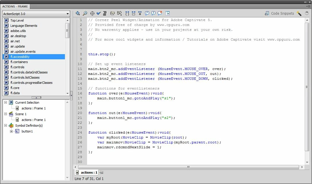

Not sure if this should go in the Flash forum or Captivate forum, but does anyone know how where to find ActionScript 3 commands for Captivate?
I downloaded a pre-made Flash button (source file) for Adobe Captivate that was originally made to make a video go to the next slide, when pressed. It does that fine, but I wanted to know how to use the ActionScript code in Flash Professional CS5 to have the button JUMP to a specific slide in Captivate, instead of just go to the NEXT slide. I know generally how code works, but have never really used it, and don’t know the specific command to make that happen. Currently the relevant part of the code in the Flash button reads:
function clicked(e:MouseEvent):void{
                var myRoot:MovieClip = MovieClip(root);
                var mainmov:MovieClip = MovieClip(myRoot.parent.root);
                mainmov.rdcmndNextSlide = 1;
I suspect that I just have to change the last line to something else and it should work, but I would need the command. Can anyone tell me what needs to be changed in the above code to make that happen?
The full code is below. Thanks.

Lilybiri
October 16, 2011
Hello and welcome to the forum,
This is the Corner peel widget from Michael Lund, which normally moves to the next slide. Did not read the agreement... are you sure it is correct to change this, please ask Michael.
I'm not a coder at all, but bit acquainted with system variables and advanced actions. The used CP-variable here is rdcmndNextSlide. The variable that jumps to a slide is cpCmndGotoSlide and slide index start with 0. Perhaps it is also possible to use the slide label, but not sure.
Another possibility: there is a Flash button included in Captivate,  to which you can attach all possible actions that are available for interactive objects. You could also change that button in Flash.

WIEZZY
WIEZZYAuthor
October 17, 2011
You are awesome. Thank you. That was extremely helpful. Michael also gave me a list of variables to use. However, when I use:
cpCmndGotoSlide = 5
It always jumps to slide 9, regardless of the value I put in the place of the '5'. So it does jump to a slide, but I can't yet get it to jump to the slide I want. In other words,
cpCmndGotoSlide = 7
or
cpCmndGotoSlide = 13
or
cpCmndGotoSlide = 44
etc,
produces the same result: jump to slide 9. I followed the same format... Any idea why it wouldn't be working?
Here is the full script:
this.stop();
// Set up event listeners
main.btn2_mc.addEventListener (MouseEvent.MOUSE_OVER, over);
main.btn2_mc.addEventListener (MouseEvent.MOUSE_OUT, out);
main.btn2_mc.addEventListener (MouseEvent.MOUSE_DOWN, clicked);
// functions for eventlisteners
function over(e:MouseEvent):void{
    main.button1_mc.gotoAndPlay("s1");
function out(e:MouseEvent):void{
    main.button1_mc.gotoAndPlay("s2");
    mainmov.cpCmndGotoSlide = 5;
Lilybiri
October 17, 2011
As I told you before, I'm not a coder and have no idea what is going wrong. I would try with a slide label, but do not know how.
