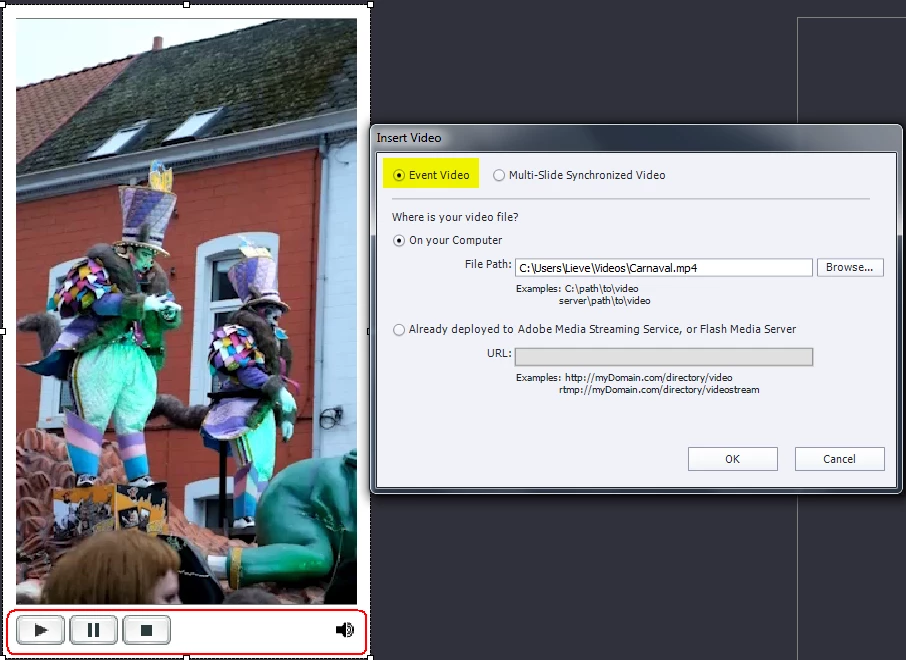

    Thank you for your help! I'm a newbie to this program, so I am not familiar with an event video, but I will definitely look into it if it works better for this project! And, yes I am using a multi-slide synchronized video.
    Lilybiri
    February 2, 2017
    When you insert a video, you have the choice between Event video and Multi-synch video. Event video will play totally independent from Captivate. Look at its control panel:
