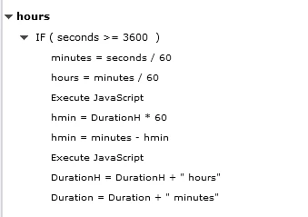

So my conditional action finally look like this:
The code executes JS for which the code is every time pretty much the same this is the first one:
var rounding = window.cpAPIInterface.getVariableValue("seconds");
var rounding = Math.floor(rounding);
window.cpAPIInterface.setVariableValue("Duration", rounding);
For the next JS the codes are almost the same, what changes is the name of  the input and output variables.
And finally the MOST IMPORTANT thing, the one it took me so much time and frustration to find out: to test all of this, a preview of the project is not enough! The project must be published and active X activated in the browser. Seems simple and stupid but I had to discover this bit of info the hard way.
