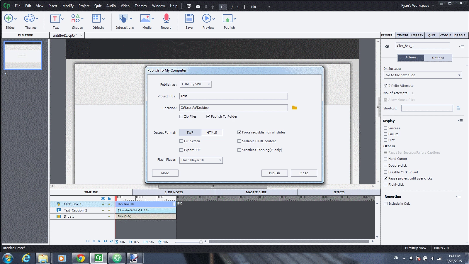

This is an embarrassingly rookie question, but I want to know how to use Javascript in Captivate so that it also works with Flash output.
Let me tell you what I am doing, which works with HTML output:
  • There is a text caption on my slide with a custom variable, numberOfClicks as its content.  The variable has an original value of "0".
  • There is a click box on the slide
  • When the click box is clicked, a very simple advanced action is triggered. The advanced action executes the following script in the current window: numberOfClicks = numberOfClicks + 1;  I know you can use Adobe's built-in "increment" action for this.
Result - When I preview this in HTML5, you can click the click box and watch the value of the variable increment.  When I preview in Flash, the value remains 0 when I click the click box.
How do I get this to work in Flash?

As you see, I simplified it some more, but I still have the same problem that it doesn't work like I want it to in Flash.

So it is JS, not an advanced action. How did you test? You have to deploy also the Flash version in a browser, which means you have to publish it.
August 28, 2015
Yes, I published once as HTML and once as Flash. Here are my Flash settings.   Maybe it is an issue with my browser?

That is not JS, but advanced actions, or do I misunderstand?
This should work perfectly, it is such a simple action. And SWF output has a much longer history than the new HTML5.. Can you post a screenshot of the advanced action?
