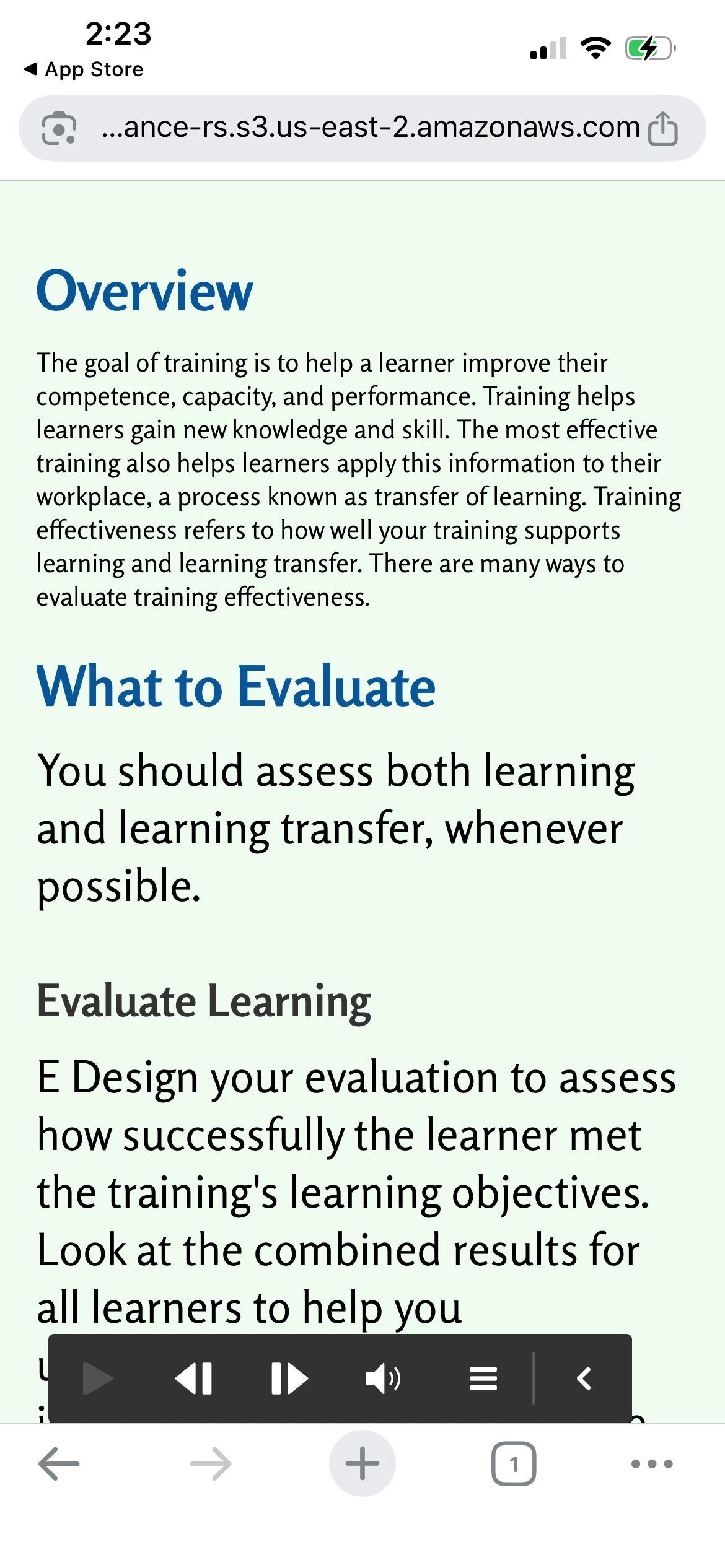

    Yes I went back into the slide, turned off auto layout, and manually set the padding, but upon publish the body text in block 1 is smaller than the body text in block 2. In reference to browser both Safari and Chrome show the same error. In desktop view the output looks fine but in smartphone view the font size is not correct. It’s not clear why this error is showing up. I attached an image for reference.
