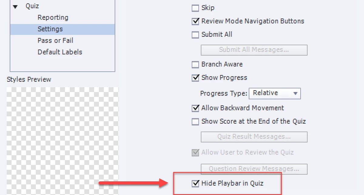

Hi There,
I'm working on a project that includes a quiz (screen shot below). There are play controls at the bottom of the module (that I did not add but seem to be a default) that actually allow the user to skip the quiz questions. I need to it so they can't advance without answering a question, and I don't know how.
  • Should I remove these play controls, in which case how might I do that?
  • Is there a Quiz setting that prevents this?
Capture
Correct answer Lilybiri
You have to get rid of the playbar on Quiz slides. Use Quiz Preferences, Settings and check the option Hide Playbar
Do not add the Skip button, but that is a default setting.
October 31, 2017
Thank you so much!
