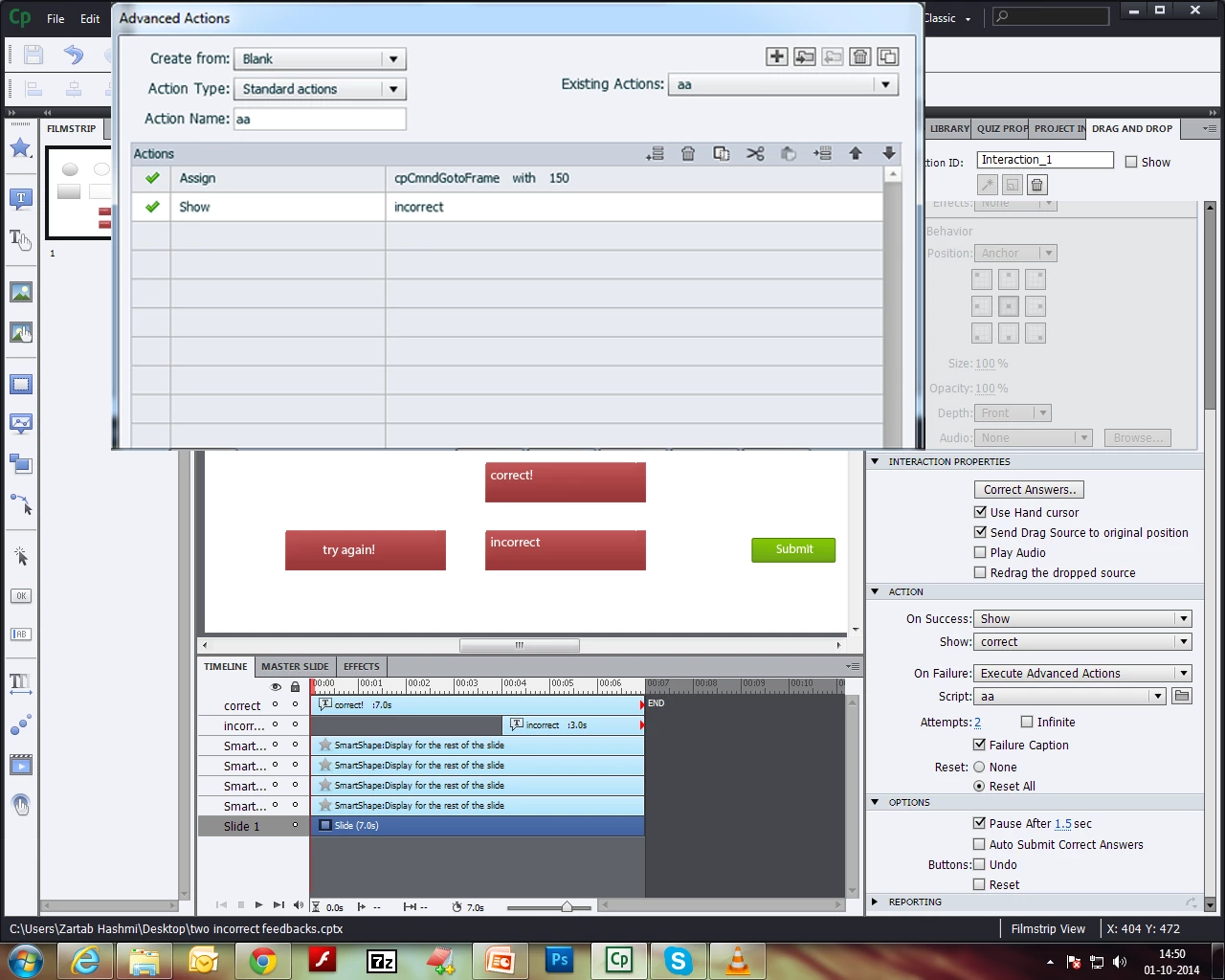

    Hi Vidya,
    Below is the screen grab for the drag and drop which has two different incorrect feedbacks.
    If you have any problem with that feel free to discuss.
    E-mail-ramanand.batra@gmail.com
