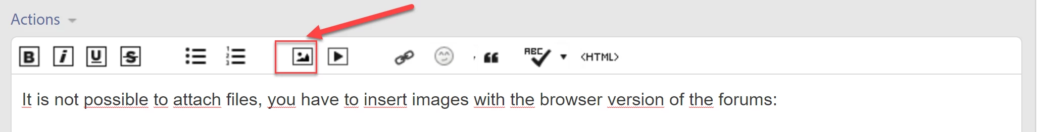

    April 20, 2017
    It is not possible to attach files, you have to embed the screenshots in your answer, using the image button in the browser version of the forums:
