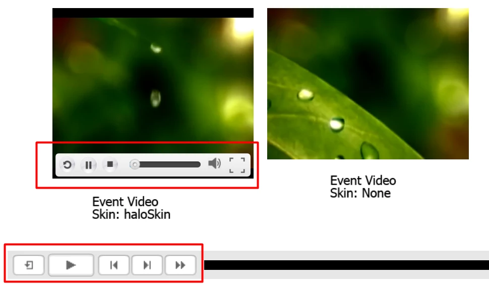

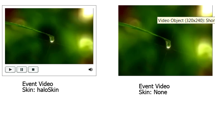

LuisXIV
Jul 31, 2019 10:08 PM UTC
Hello Melvin,
There are two type of video,  Event Video and Slide Video.
See image of Event Video. With Skin and Without
Now you see the control in the event video with haloskin, when you click on the video during preview the control will show up.
As you can there are two control. You only need one. image2 is in HTML5 in Browser.
see image2
To Hide  the top Video Control in the Properties tab in the Skin dropdown select -->  Skin: None
The other control is under the menu  Project --> Skin Editor  (Shift+F11)
You can also create you own navigation.
Luis
