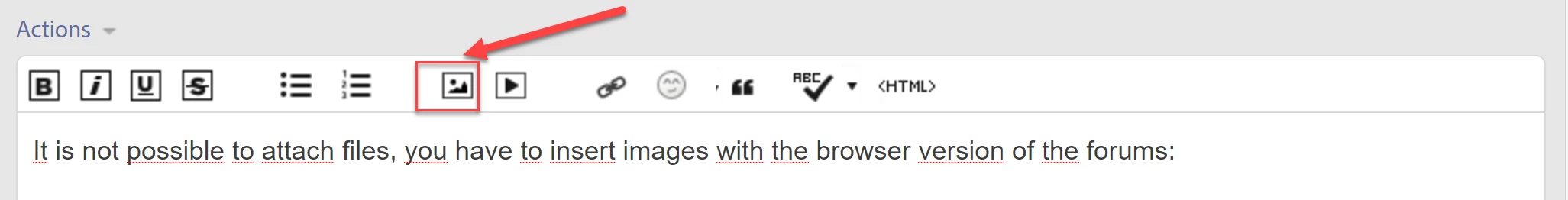

    I suppose you are posting in the eLearning portal, cannot add media there neither. If you come directly to the Jive Adobe forums, where the questions are synchronized, it is much easier to insert images or video:
    If you want to try, this is the direct link to your thread:
    Re: How to control volume of audio recording?
