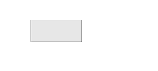

    Is this minimalistic example along the lines of what you were thinking?

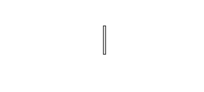

    That example is similar to what I would like, but the box is just a narrow vertical bar, the box you've show does the job of hiding the text, in my case the text is visible to the left of the box as it slides in, which is what I am trying to mask out of view.

    Well, that does complicate things a little further.
    What I have done here is to place a white box with no border over the text and shrink the larger box. This serves as the mask but your specific environment may be less suitable for that.
