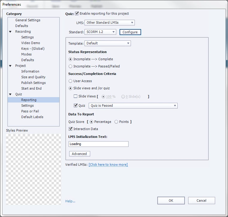

August 18, 2016
Yes, enable reporting and identify the standard of choice.
(Your LMS Documentation or user forums would likely have best practice on how to configure these.)

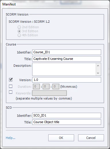

then Configure:

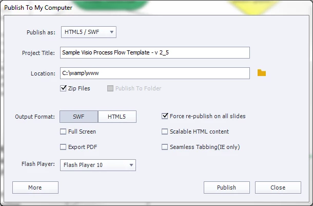

Oh, and finally, publish as a ZIP file:
