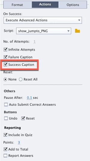

How to display success caption for duration of lesson?
I have created a project with four drag and drop quizzes. Each quiz can be attempted as many times as needed, and returned to at anytime. When all four have been completed successfully the Next navigation button on any of the quizzes takes the viewer to a final congratulations slide. All of this works fine. Here's my question:
I would like the Success Caption to stay visible on the successfully completed quizzes. This way if a learner returns to a quiz they already completed it will show the success caption. Is there a way to have the success caption stay on for the duration of the lesson?

    I suppose that those D&D slides are created as Knowledge Check slides? If they are real Quiz slides, it is not possible to revisit them to have another attempt. Like normal quiz slides, once you leave the D&D slide configured as scored Quiz slide, the answer is blocked and the number of attempts on quiz level are considered to be exhausted. But if it is configured as a KC slide, the answers are reset when you leave the slide.
    For the Success shape (it is mostly a shape, not a caption), its normal timing is 3 seconds. The Success action will be executed after that display time. I would consider to take out the embedded Success shape and replace it by a custom shape or caption which is initially hidden in output. Use the Success action to show that custom shape and the normal action you want to happen. In that case the custom shape will remain visible as long as you don't hide it again.

    Now I am confused. In the question I read clearly: "drag and drop quizzes." And my answer was meant for drag&drop slides. That is why I asked if they were set up as Quiz slides or Knowledge Check slides? A KC slide is NOT scored, a quiz slide is scored. AFAIK it is not possible to create 'custom' drag&drop slides, as you can create custom quiz slides like MCQ, T/F, Matching, Sequence... A D&D slide has a lot but not all features of those other quiz slides, but is never custom.
    In the screenshot I see that you did configure the D&D slide as a quiz slide, with Infinite attempts. Please, never put the pausing point at 0.1secs, leave it at 1.5secs, this is too close to the start of the slide. I don't know which objects are used for drag sources, drop targets but it is never a good idea to pause so early. What was the reason for that change? Since it is configured as a 3pt scored slide, it makes no sense to come back to the slide to answer, since the answer will be blocked when you leave the slide. Or did you change the Quiz Preferences to 'Submit All'? Never tried it with D&D slides... may work.
    You created an advanced action, would like to see that action.  It needs to include the 'Show FeedbackSuccess' command if you want to go with the workflow, and just deactivate the Success shape (it is not a caption, that is a terminology bug).  I need to see the advanced action, because you may expect to have the learner see the FeedbackSuccess shape before moving on to the next slide, which is probably included in that advanced action. With this setup, learner will need to accomplish the D&D slide before being able to move on. That is different from what you wrote in the question. In that situation I don't see any advantage in having that Success feedback message displayed eternally. If you want to allow a Review of the D&D slides, you will have to set it up manually. Here is a blog explaining a possible workflow:
