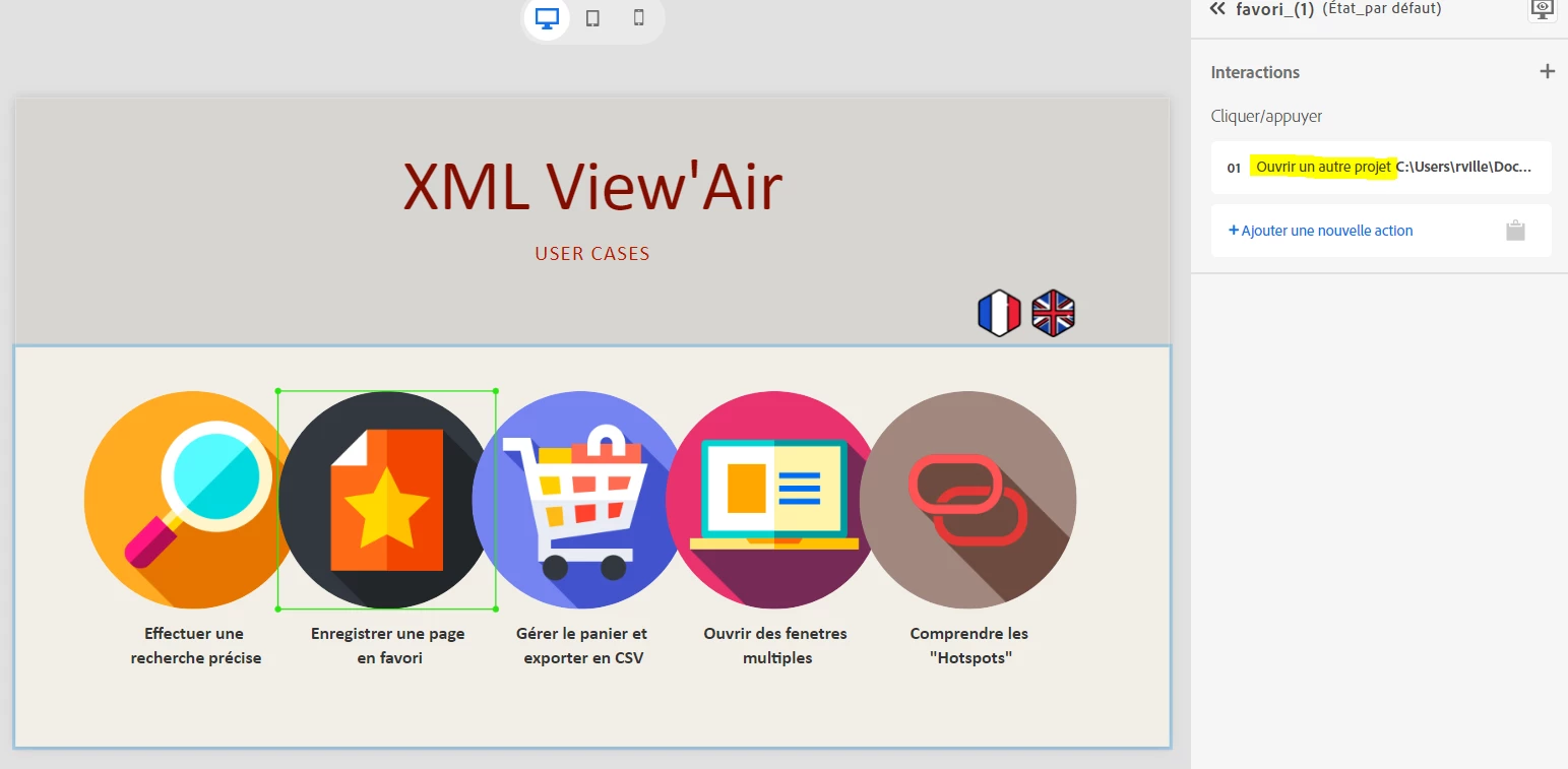

I've designed a set of projects and each of them is linked with the other through interactions, but when I publish it, the link doesn't work. I don't work with HTML pages oftenly so I guess I'm doing something wrong, how do you do so that two project are linked together as html pages (after publication) when you click on a button ?

You will not be using a LMS but just uploading the projects to a websever? I see that you are on the new Captivate. Can you explain your workflow so far to link to the projects? Are you using the URLs of the published projects?

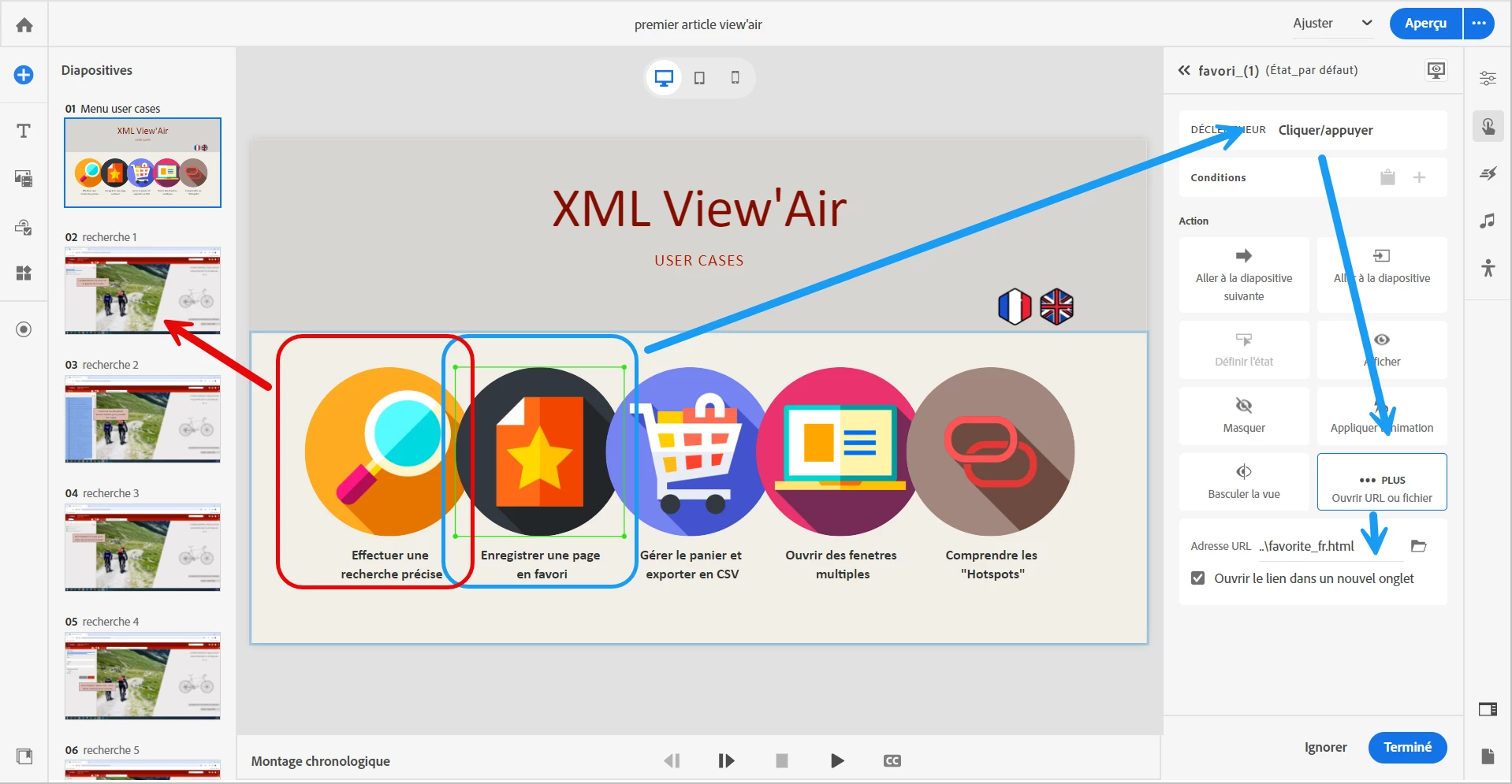

Yeah, the company I'm in doesn't have an LMS, so the idea is that the menu (in html5) is linked with all the projects I made.
On the picture below you've got my work :
  • In red this is the first project so basically it's
    • Menu 1 --> First user case --> Menu 2 to relaunch the simulation, go back to menu 1, close the lesson
  • In blue this is the second project
    • Menu 1 --> URL link to project 2 --> Second user case --> Menu 2 (on project 2) to relaunch the simulation, go back to menu 1 (Project 1), close the lesson
But when I publish and try the second case, I have a blank screen with a message error OR I go back to menu 1 and there is no way to access menu 2. I think it has to do with how I place the different HTML pages but I don't know sh*t about computer science so I'm left in the dark here ^^'

Did you upload the multiple projects to the same webserver and use the URL to the index.html file?
