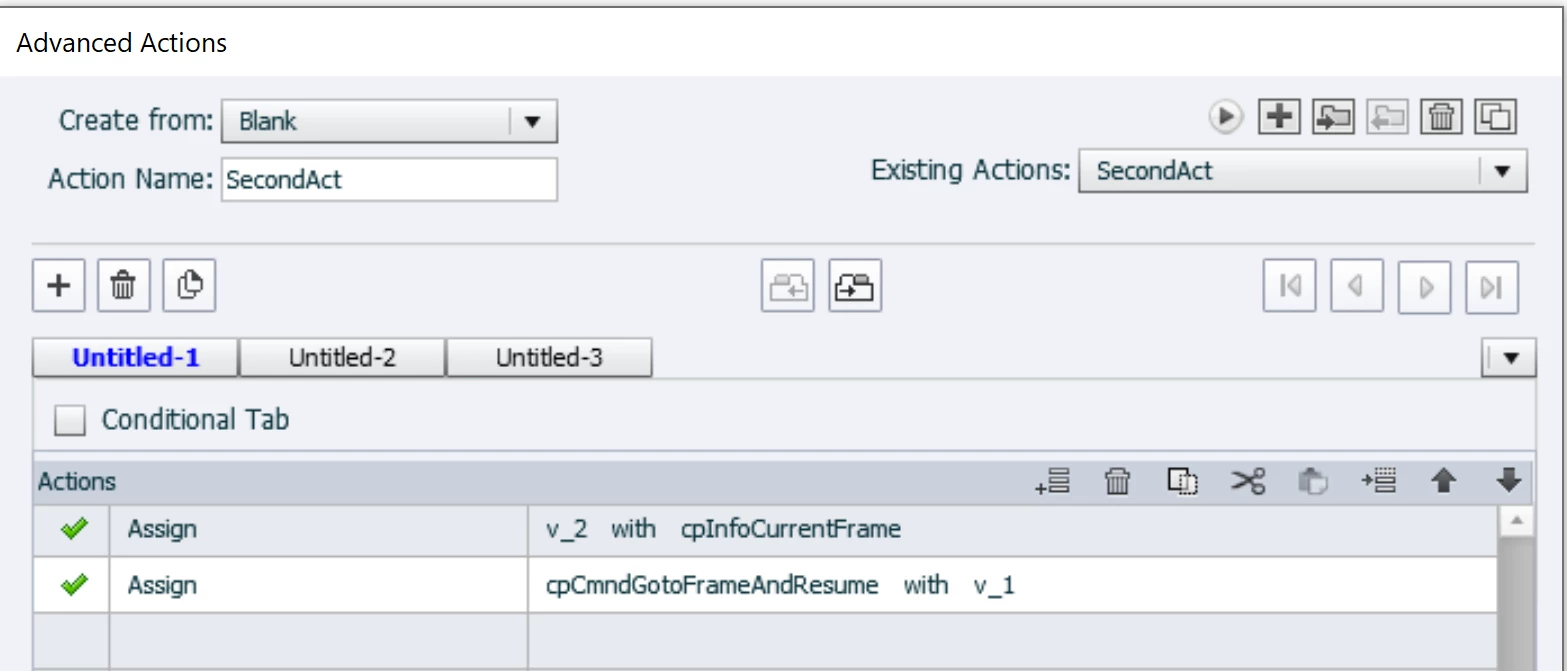

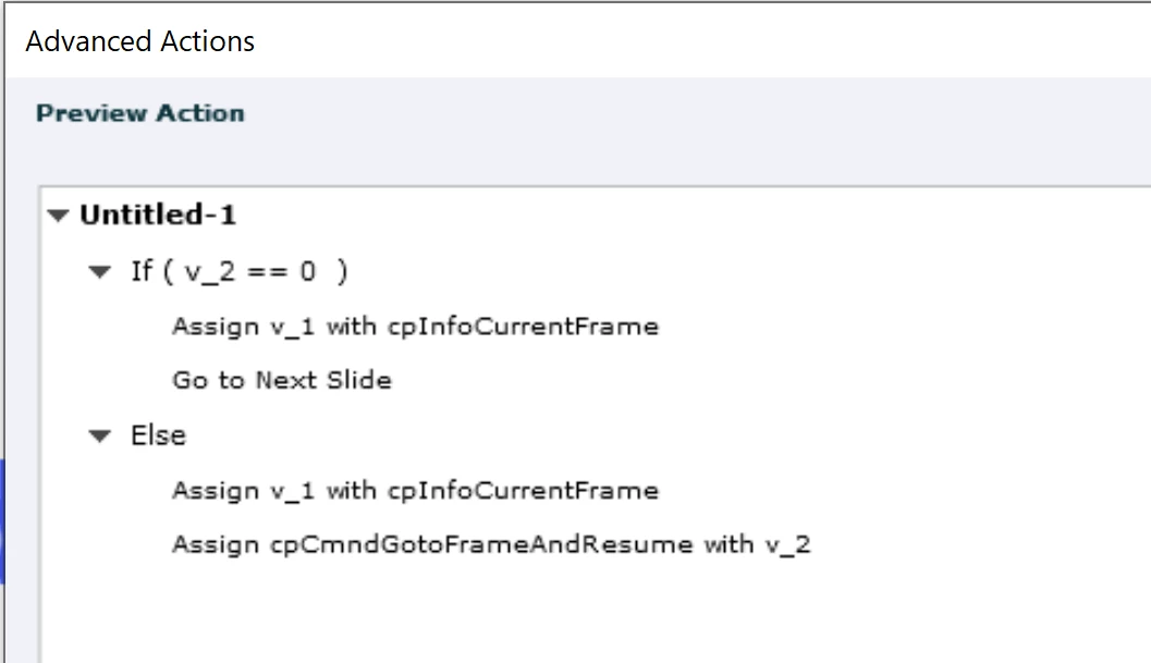

    Correct answer Lilybiri
    Sure Madam. I'll wait for the solution.
    Create two user variables, v_1 and v_2. You can set the start value at 0 or leave it empty.
    For the first button on the first slide, create this conditional action:
    For the second button on the second slide:
    Move the pausing points of both buttons so that they are not on the last frame but after the audio clip.
    Please test this out.
