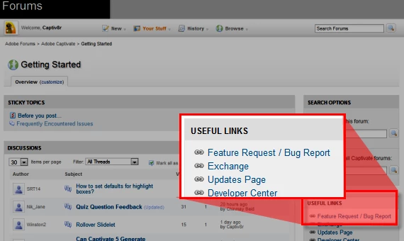

In my signature line is a link that will open the Enhancement Request form. Additionally, you have a link on all of the Forum pages as shown below:
