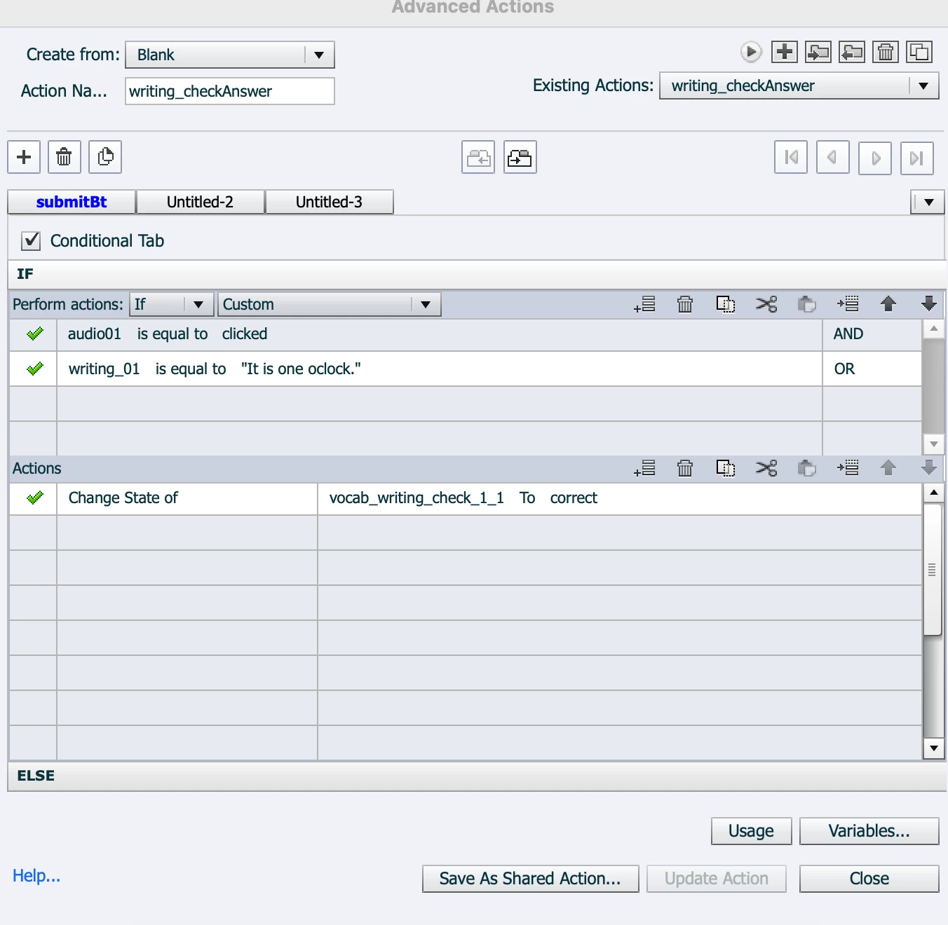

I have a project where users need to write the time in a Text Entry Box.
1. Users clic a speaker to hear the audio (tells the time.  For example: It is one o'clock.)
2. Then, users type that sentence time in a TEB.
3. TEB has a variable declared (for example: writing_01 is equal to It is one o'clock)
4.  Then, a submit button checks if writing_01 is equal to the given sentence (for example: It is one o'clock).
Issue:
When users type the word o'clock (the submit button gives an incorrect answer). However, when I removed the apostrophe the answer is correct.
Problem:
Users learned to write o'clock with the apostrophe.
Can you suggest a proper way to handle the apostrophe?
Thanks.

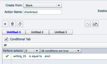

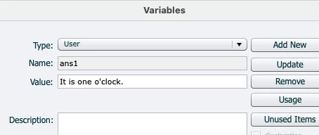

    Ok the issue is the use of the apostrophe.
    There are two ways that you can get around this...
    1. Create varible(s) that will be used to represent the correct answer for a given question.
    The your advance action would be like so:

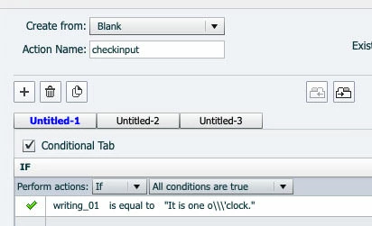

    2.  You can use a fancy escape method so that the apostrophe is able to be used in the string when doing the compare in your advanced action like so:
    In order for the apostrophe to be used during your compare, when using and advanced action, you will need to put three '\' characters together and then your apostrophe = \\\'   This will allow the correct answer entered by the learner in the TEB It is one o'clock. to be evaluagted allowing for the correcgt ansewr to be determined.  Please keep in mind that case sensitivity plays a role...so if the learner was to enter it is one o'clock - the lowercase 'i' would then yeild a wrong answer.
    This should get you back on track!

    The image for my answer above that goes "1. Create varible(s) that will be used to represent the correct answer for a given question.   The your advance action would be like so:"
    Sorry I fogot to add the image...
