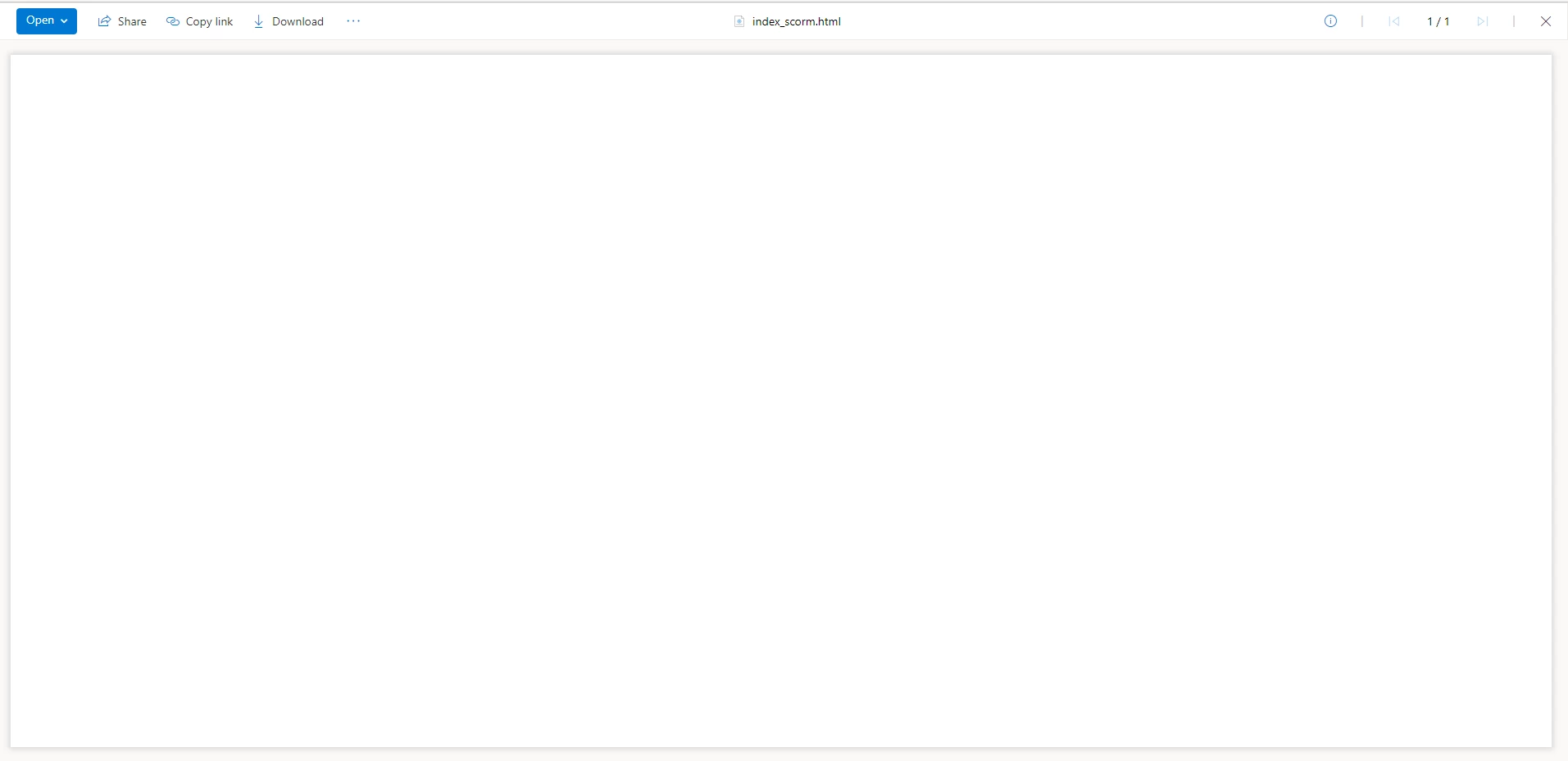

I recently completed a software simulation in CpC and we are deploying it via a departmental SharePoint site. (We do have a LMS but for the moment we are fighting the "Cannot load LMS API..." battle...that's another story.)
The output plays fine locally, and I was - after some tweaking of quiz settings - able to load it to SCORMCloud.
According to our IT folks, they *do* allow .json files in SharePoint, so that rules out the usual hiccup.
When I try to launch the index.html (or index_scorm.html) I am presented with a blank screen. (shown here) and the course doesn't launch. This issue happens regardless of browser used.
Any and all guidance will be gratefully received at this end.
-Mark
Screenshot:

It looks like you created a SCO, because you launch from the file index_scorm.html.
However Sharepoint is NOT a LMS, which means you cannot deploy a SCO on it. You need a LMS for that purpose.
Aug 8, 2023 6:42 PM UTC
Thanks... I am aware that it's not a LMS, however, even when I turn off quiz reporting and use that output to try to launch the index.html, I get the same result.
Lilybiri
Aug 8, 2023 6:45 PM UTC
Can it really be functional as a simple webserver, because that is required when you upload a non-SCO published output folder. In the past I learned from other users that that was amongst the functionalities of Sharepoint but I have no experience with it. It is correct that you should publish without activating Reporting for a non-SCO but I just saw in the screenshot that it was trying to launch the SCORM index file.
