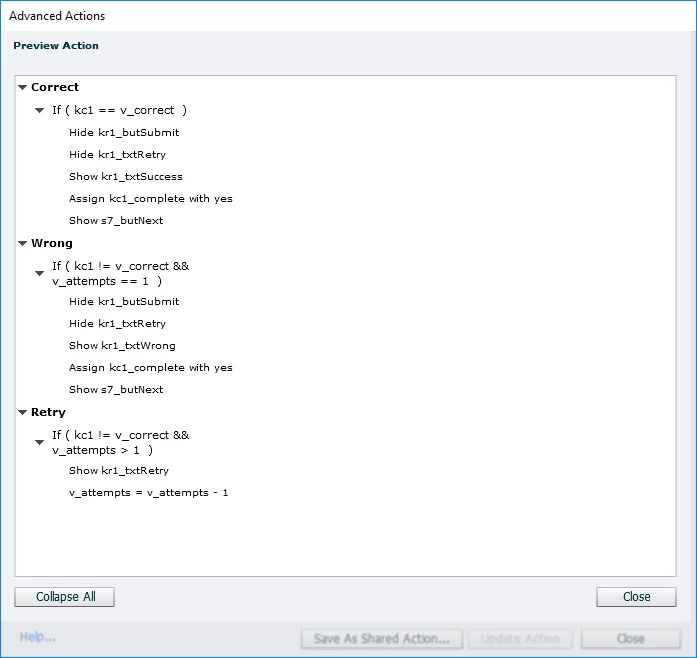

    Can you post a preview of the advanced action please? HTML£5 output is much more sensitive to small logical bugs than SWF output.

    v_attempts is set upon entrance to the page via enterPage action (usually set at 2) - this way, upon returning to the page, it remembers the user has already been here and stores it in kc1_complete.
    v_correct is the literal that matches the answer (in this case "X" - without quotes).
    kc1 is the name of the RBW that should be returning the variable (above I used "myRB").

    I still don't fully understand the action, sorry. Which variable is associated with the radiobutton interaction? One  guess is that you have to look at the AND conditions in second and third deicsion. A combination of a 'not equal to' and 'equal to' has caused me already issues in the past.
    For Booleans I always use numbers, never Yes/No, seems to be more trustworthy.
    Did you check if the variables get the expected values by inserting them in a text container?
