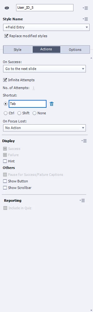

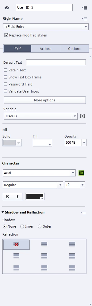

I am running the cpExtra widget and using the xcmdnPreventTabOut so that tab can work as a submit button for the TEB. The entry into the TEB is stored in UserID. I then call this variable on the next slide, but it stays as null. Can someone help me out with potential issues of fixes?

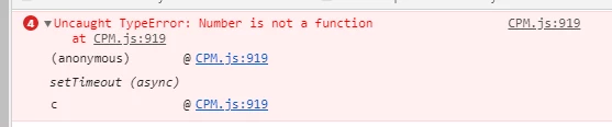

Even when I test with deleting all the other slides in the project, the browser developer tools register an error every time I type into the box. The error originates from the primary Captivate javascript file. Looks like a bug in Captivate to me.
