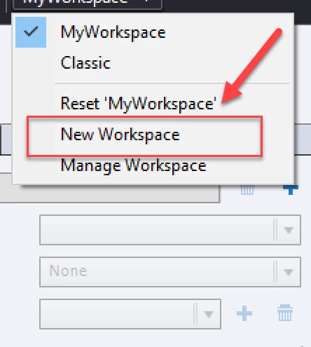

Hmmm, I have CP2017 and the first thing I do (after checking backups) is to switch to Expert UI and to set up workspaces.
What was your work flow? Are you able to insert panels in docking stations, to make panels floating and have the big buttons Library and Properties disappeared? If yes, you are in Expert UI. Set up the panels as you want them, then open the dropdown menu where you see Classic and choose the option New Workspace, you'll be able to save that setup under whatever name you want.
