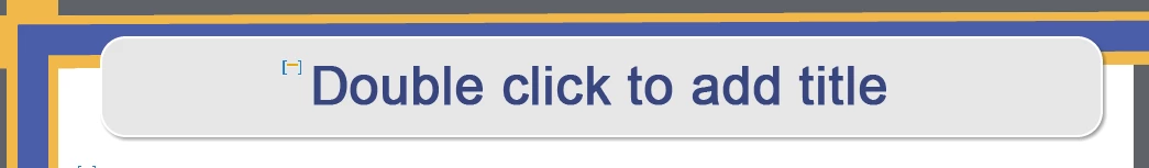

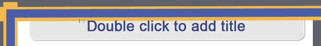

I'm having an issue with objects being rearranged on the filmstrip view of a master slide.  Below is an example. The top picture is what my master slide looks like and the bottom is my filmstrip version of the same slide.  I've tried in both Captivate 9 and 10 and have the same issue.  Anyone have any suggestions? We've tried grouping items together and it works for a short while and then goes back to having issues.
Master Slide
The arrows point to the gray box and the title placement holder.

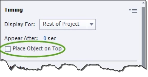

    A couple of things come to mind on this one. If you have any objects that are displayed for rest of project you may wish to consider the checkbox on the timing panel "Place Object on Top" depending on what the desired effect is.

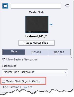

    You may also check your slide properties as well. There is a similar checkbox that will place master slide objects on top. Might be useful in some circumstances but could be interfering with your layout.
