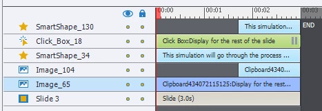

Above you can see the timeline for the slide. The selected image is the one that should be displaying. It is set to appear immediately with no transition or effect. The image listed above it (104) is not included in the initial breakpoint. It is a "zoomed in" image used on the Tablet Portrait breakpoint.

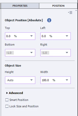

Above are the Position settings for the image selected above.
