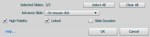

    If you are speaking of animation timing, it should come over from PowerPoint. But if you have animations set to 'On Click,' in PowerPoint, beware not to import slides to Cp with the 'Click to Continue' option, as the user will have to click twice for the slide to progress.
    PowerPoint Animation:
    Cp Import Options:

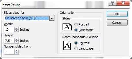

    See what the page size is for PPT:

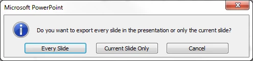

    Export a slide or all slides to images from PowerPoint via 'Save As' and select .png:
    Use the size of the exported image as a guide for the Cp project resolution.
