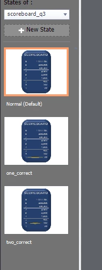

I attempted a game show style activity where each correct answer would increase the score on the scoreboard. I made the images of the scoreboard at each point interval, then loaded them in as states of the original scoreboard. For each correct answer (button), the advanced action is set to make those scoreboard images "Go to Next State" as well as advance to the next question.

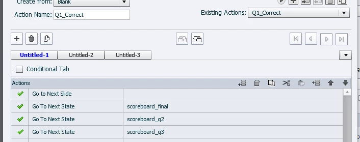

    Can you insert a screenshot of the Preview Advanced Action which you use, and tell which event you are using to trigger it?  Need to see the logic You can change state for a multi-state object when you are on another slide with an advanced action, that is not the issue.

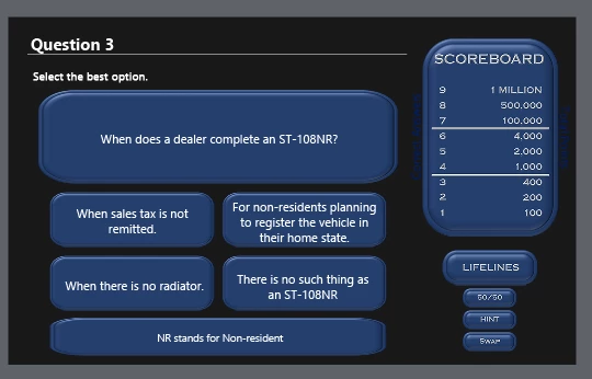

    Here is an example of a question slide. Any of the three incorrect answers just advance to the next question. The following image are the states showing the point total going up, followed by my advanced action.
    The purpose was that each correct answer would add points; no loss of points for incorrect answers. If there is a known way to do this simpler, I would take any suggestions!
