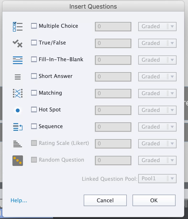

    If you insert a 'Knowledge Check slide' and select the Hot Spot option (see below). Then you can add a screenshot of the system and place the hot spot on the correct answer.
    The feedback fields (Correct/Incorrect) are ready for you to fill.

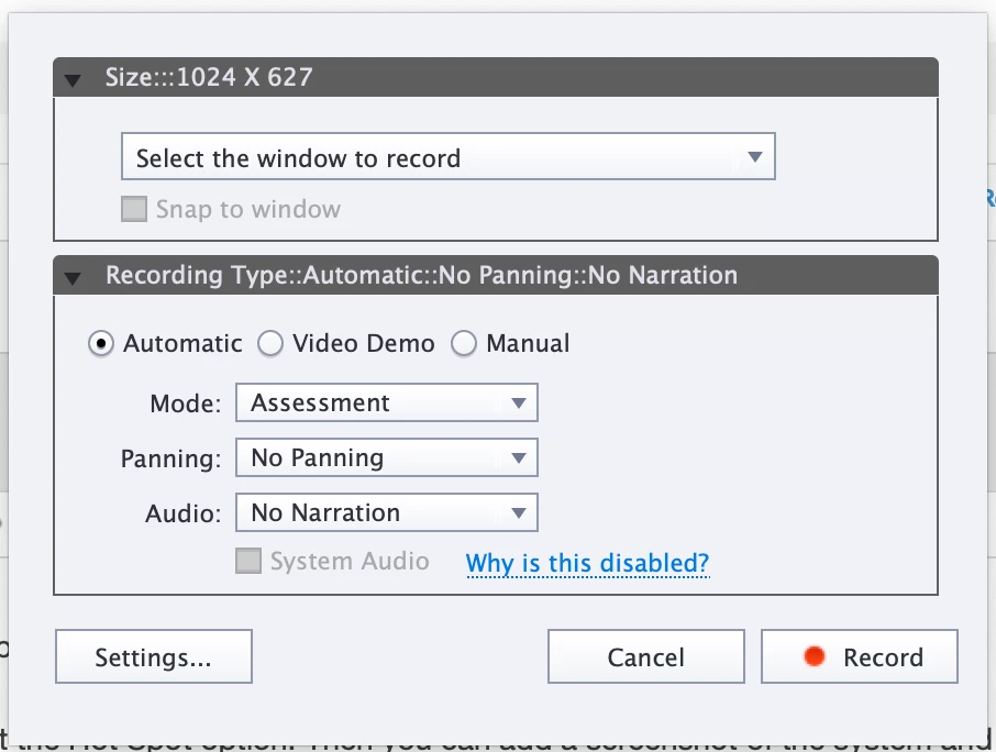

    Otherwise, you insert a "Software Simulation" and select the Assessment option in the drop down. (see below)

    Thank you! A quiz hotspot slide was actually exactly what I needed - so simple!
