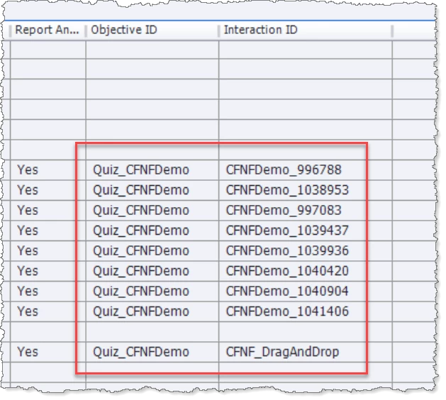

    Go to the Project > Advanced Interaction dialog and look at the Objective ID and InteractionID for each quiz question.  Look for any inconsistencies.  Ideally all questions should belong to the same Objective ID, but they should have unique Interaction IDs.
    If this project file is just a Save As from a previous project CPTX, then you may have quiz questions here that have the same IDs as a previous project that also resides on your LMS and that might explain why you are seeing answers that do not belong.  The LMS is pulling up data from a completely different quiz and interactions.
