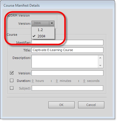

The Multi-SCORM Packaging tool CAN create both SCORM 1.2 and 2004 packages.  But you need to select which one you are going to create when the dialog opens.
I would say perhaps you left it at the default SCORM 2004 setting and that's why you were getting an incompatibility error message when you tried to load it up with SCORM 1.2 published content.
