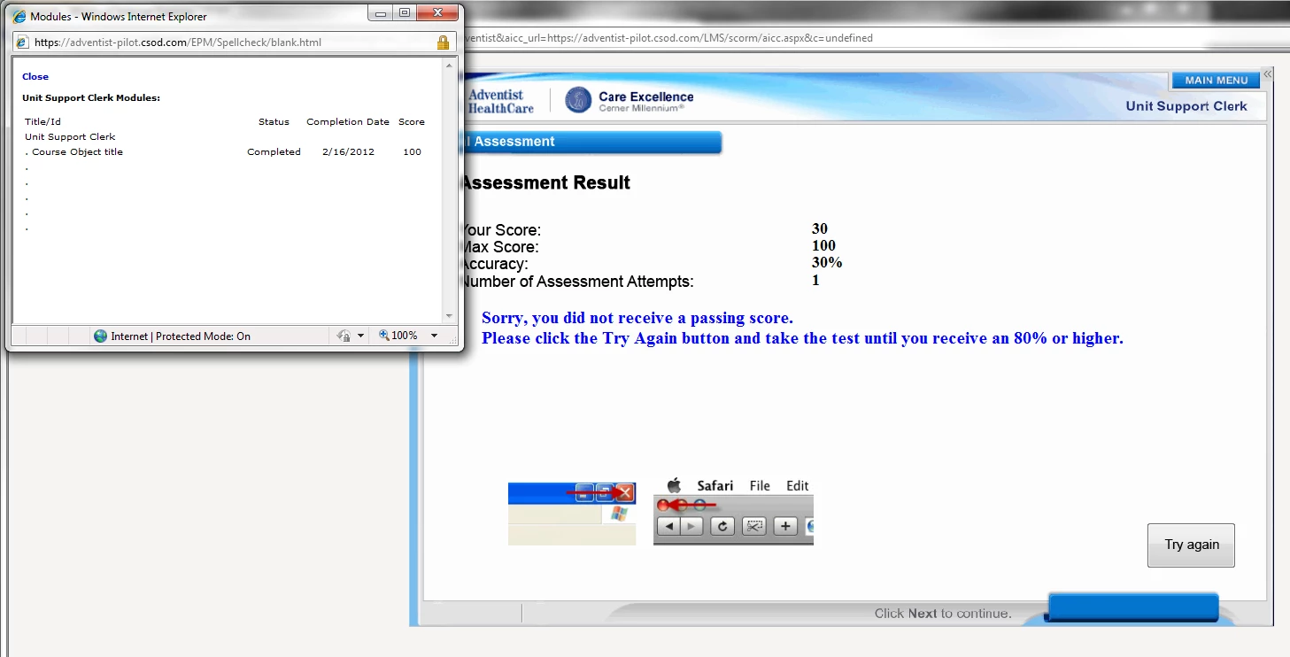

An issue that has recently come to my associates and my attention is an error that happens randomly where the score at the end of the course is not passed correctly through the LMS (CornerStone). It is an issue that happens so erratically we are unable to replicate it in testing. Attached is a picture of a recent time where the score at the end of the test was not transferred correctly to the LMS.
Here the learner got a 30 out of 100 (30%) and need an 80% to pass. However, here the leaner received a score of 100% and a complete in the LMS even though they failed the course with a 30%. I would say this issue has a less than 1% of happening, but do to the importance of these course with new policies any random passes are not acceptable. The test is a ten question test with each question worth ten points. Sadly it is not just this course that is being affected but this unpredictably issue. We have had reports that every course has had this issue of the score being incorrectly transferred on atleast once.

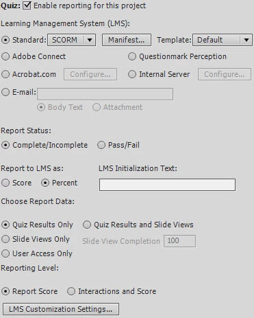

Attached below is a picture of the settings we are currently using for our courses. For the record we have chosen to use scorm 1.2 over 2004 as there is a known issue with Captivate and (LMS) CornerStone with the complete/ incomplete. Also we are using Never Send Resume Data as we were having freezing issues related to bookmarking. We are currently using Captivate 5.5.
