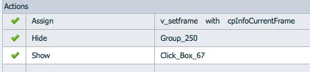

I'm having issues about when reopening a course in my LMS the course does not start from the very beginning but from a chapter with a video. I've checked other courses which works the way I want and I've done the exact same settings so I cannot figure out what the problem is.
I'm aware of "bookmarking", so if you decide to close the course before finishing it and reopen, you will start from that slide. But, for now I performed the whole course without closing it and it restarts from the wrong slide.
My primary On-Enter slide settings on the video slide (same as previous courses):
But I wondered if I might change to this instead:
Is it the first setting that might cause the problem? (Can't check it for the moment due to connecting problems with the LMS.)

sassasol
sassasolAuthor
May 14, 2017 2:16 PM UTC
Hi Rod,
Thanks for answering.
So, in other words my issues has nothing to do with the On Enter slide actions?
RodWard
May 14, 2017 3:38 PM UTC
I don't see it as being connected, no.
