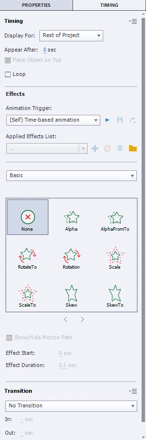

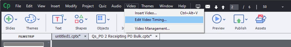

I'm wondering if there is an update on this? I am using Captivate 9 and the menu is very different than this one.
I can't find the edit video timing; there is a timing tab, but no edit.
Andreas Kuswara
October 30, 2018
nvm, found it :-)

Hi there,
Thanks for reaching Adobe Community.
You can accomplish this task with the Multi-Slide Synchronized Video in captivate 6. You can do so by clicking Video > Insert Video > Multi-Slide Synchronized Video. You can edit the video timing by going to Video > Edit Video timing.
Once the video is distributed between the number of slides you want. Then you can select the slide and insert a quiz question slide in between.
