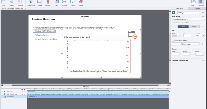

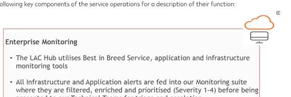

Inserted a picture into rollover slidelet and it is showing a cross at the top right hand corner
I have inserted a rollover slide-let onto a page and within the slide-let I have pasted a text box and a icon/picture - the text displays fine but the image although it displays fine it has a little box with a cross in it at the top right of the image (as demonstrated below)

That little box with the cross is actually to close the rollover slidelet once you set it to "stick" after the hit area is clicked.  If you don't want to see that little X then turn off the Stick Slidelet option under Actions (when you select the hit area).
However, I would also recommend you reconsider using slidelets at all because they are only compatible with SWF output and not HTML5.  When Flash output can no longer be used you would be faced with redoing this interaction anyway.

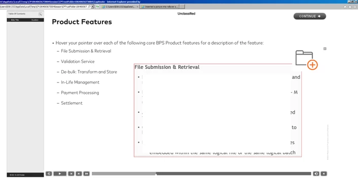

That doesn't seem to have resolved the issue - do you have any other suggestions?
See below with Stick Slidelet unselected and preview

You seem to have quite a few slidelets on that slide.  Is the stick slidelet option turned off for all of them?
