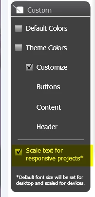

    Lilybiri
    September 2, 2015
    Can you check if you see this option :
