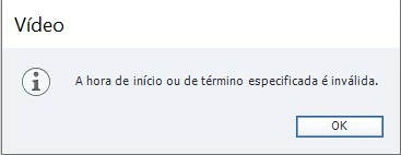

When I try to import an interactive video from my computer to my project an error message appears: "The beggining or finishing time specified is not valid". Does anyone know what this mean?

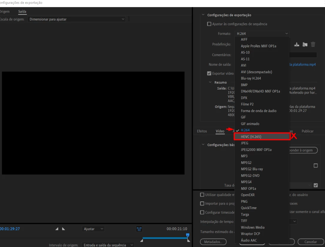

    Hy Lilybiri! I realized that the edited video was exported with HEVC(H 265) format. So the Captivate couldn´t read the archive. Then I have changed the format to H 264 and it worked.

    Hy Paul! I realized that the edited video was exported with HEVC(H 265) format. So the Captivate couldn´t read the archive. Then I have changed the format to H 264 and it worked.
