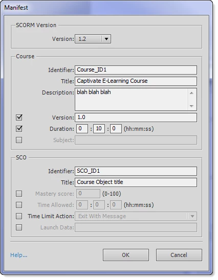

    You should not have spaces in an ID field name.  So make sure the name entered in your Course Identifier field and SCO Identifier fields has no spaces or uses underscore characters between words.  Also, make sure you don't use exactly the same ID for the course and the SCO.

    Please show us screenshots of your SCORM Manifest dialog settings.
    Do they look more or less like this one?
