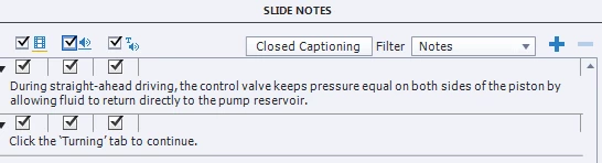

    To add cc, you begin by adding notes text to a slide in the 'Slide Notes' panel:
    You may convert that notes text to speech using TTS(2), or add an audio file to the slide.

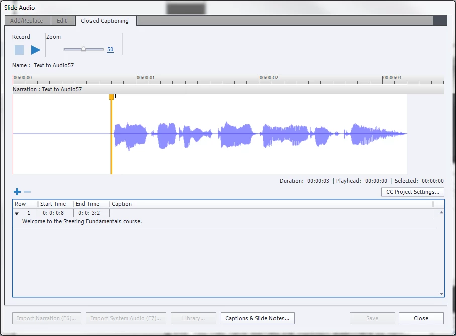

    Once there is an attached audio file, you can select the cc check box in the notes panel(3) to allow display of the notes text as a cc item.
    You can then edit timing for the cc text against the slide audio(4).

    Lilybiri
    May 16, 2016
    Hmmm, original question was about video, not about a slide-based cptx. You need to use the first button in the Slide Notes in that case.
    BDuckWorks
    May 16, 2016
    Yes, you must enable the video CC link as well:
