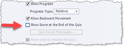

    Yes it is possible to hide the Quiz Results slide in Captivate by deselecting the option in Quiz Settings to Show Score at the End of the Quiz (shown below).

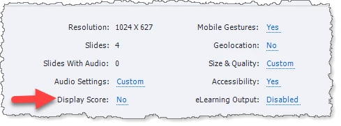

    This same setting about the visibility of the Quiz Results slide is shown on the Publish dialog as shown below.  It's not a different setting at all.

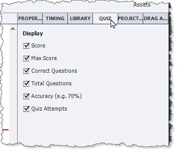

    Another way to hide the quiz results from the participant is to still show the Quiz Results slide but deselect the checkboxes that determine which of the quiz details are shown on the slide (see below).
    This will still allow the Quiz Result slide to be published with the project but just not show scoring details.
