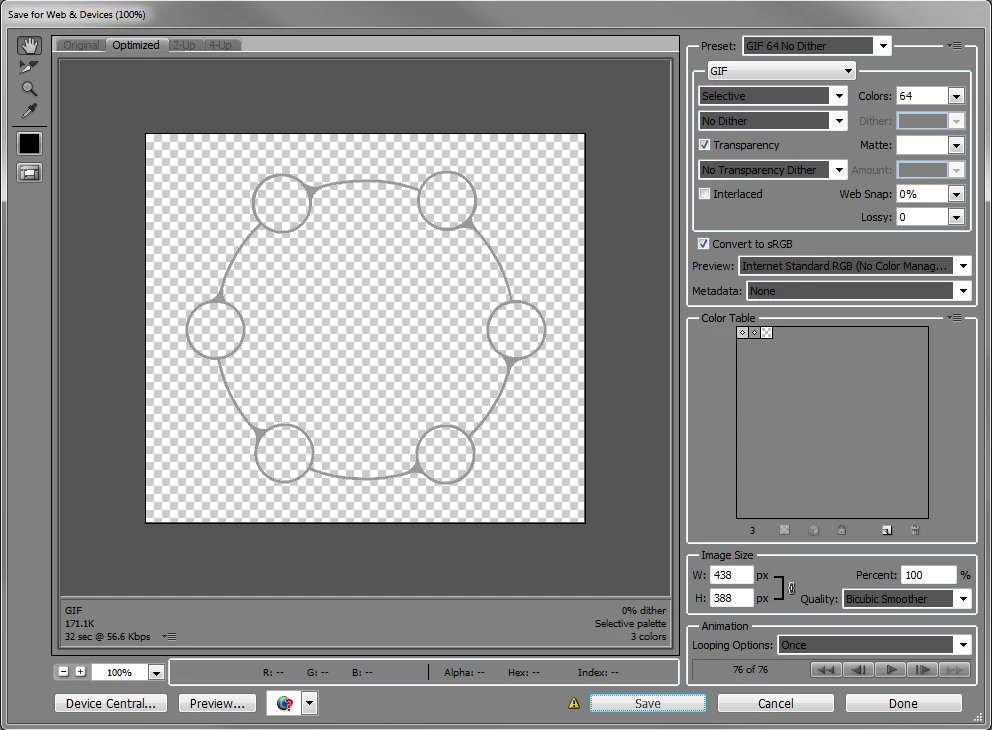

But may I ask the settings (to save the files) you used for your animated gif files? The problem with mine was that the animations would not play (most of the time) when I would run the slides with the animations in IE and Safari. The animation looked fine in Captivate but as soon as I pushed them out to HTML5 animations would not play. I have been using Photoshop with the following settings in the image below:

I didn't use Photoshop - I used Fireworks to do it. I simply imported the images and attached each to a separate 'state', set the timing, and published. There are tutorials online that show how to do it.
I just tested an animated gif in Captivate in both Chrome and IE11 and works fine in both. I am on my windows 7 laptop this morning so can't test on Safari but I can't imagine it wouldn't work fine. I am only viewing it in HTML5 output. I don't use the swf output anymore. That said, I just noticed that, oddly, upon import Captivate places the animated gif file into the Library with the swf extension.
