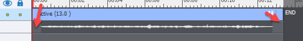

    As for audio: be sure to use WAV-files. Import all audio clips to the Library. Drat them to the appropriate slide. That is the quickest work flow? If you expect some users to have lower bandwidth, or if you want to create responsive projects (but exclude PPT in that case) I recommend to leave a small gap nbefore and after the audio clip:
