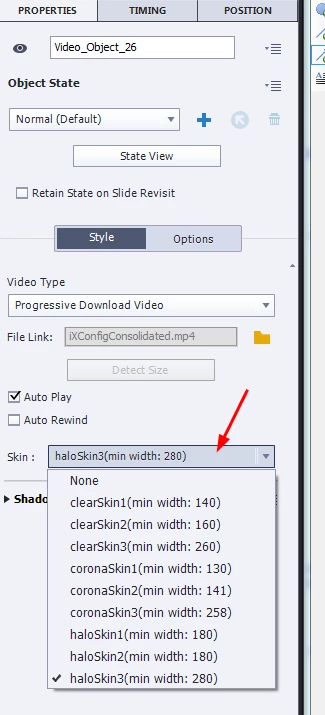

Is there a way to change the "Video" playback skin in Captivate 2017?
I can select the skin from the list but they all appear the same way, no change no mater which one I select.

    Nov 21, 2017 8:41 PM UTC
    Video players skins work for event video ONLY when exporting to SWF. They do not work for HTML5 export.
    the suggestion or multi-slide video is just a work-around for those that want to keep their videos branded with their own skin.
    The real answer for Event Video is NO - you are not able to customize these skins. Although I imagine someone has some scripted work around.

    Oct 6, 2017 8:01 PM UTC
    this is in a responsive course. Video type is Progressive Download Video. Skin options shown below.  Regardless of selection, playback bar shown at bottom is what I get.
