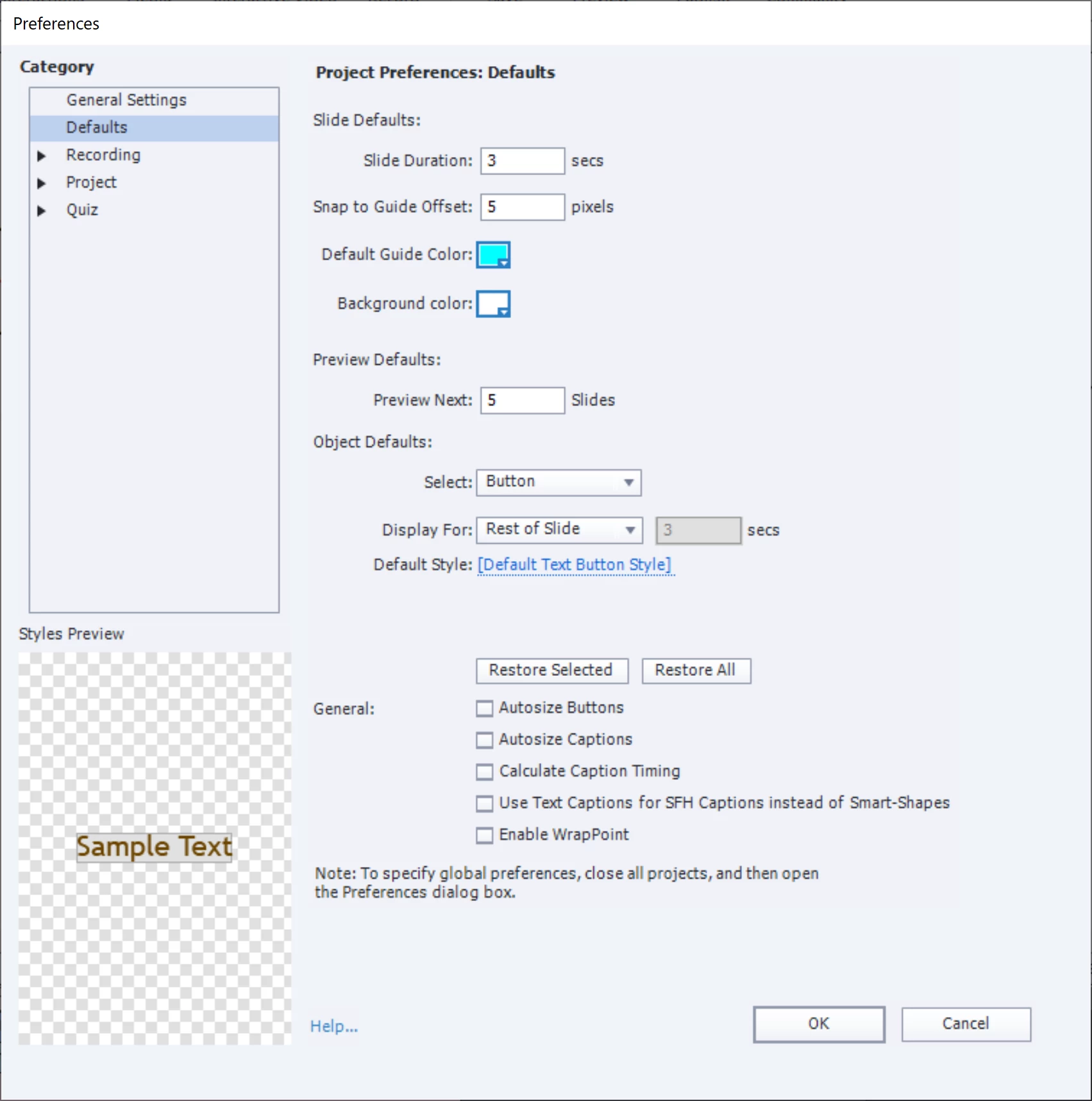

    Lilybiri
    Aug 5, 2020 5:27 PM UTC
    When I install Captivate I always set up some global Preferences. One of them  is to edit the default duration of most objects, from 3 seconds to 'Rest of sldie'. Because that is mostly what I will need in all projects. Have a look at my setup, here for button:
    As for the difference between attached to end of slide (red triangle) and for rest of slide,  you wouldn't have to bother about them anymore. The red trianlge, which means end of the object timeline is attached to the end of the slide timeline, you wouldn't see it appear anymore.
