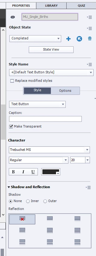

    Thank you for your answer. I think I have it figured out now, except I don't have the "Retain State on Revisit" option that I can see. Is there something I need to enable?
    Lilybiri
    Apr 9, 2019 10:25 PM UTC
    I thought it was added in 9.0.2 but may be wrong.
    In that case you need tracking Boolean variables, and use the On Enter event of the slide to reset to the correct state.
